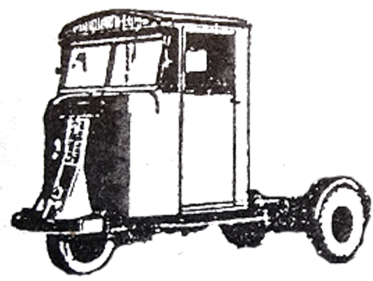

That's a bit of a challenge, as there's no front view on the mechanical horse website, and I have not found any alternative drawings. There should be enough to scale from...
this drawing from
lots of details missing, of course.

I had seen that one, but its a useful reminder that the trailers only fit the correct tractor. A 3t trailer has a narrower gauge for the flanged wheels on the coupling so apparently will not couple to a 6t tractor, and vice versa of course. My trailer couplings were made to the narrow gauge…
I checked, the Roxey kit is quite wrong…. Height, wheel diameters, gauge of couplers, etc.
