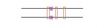

However, I'm thinking of seeing if I can retro fit smaller neowhatnot magnets which would hopefully require less tunnelling but as I say it's kind of far down the list.
Rob.
Sorry, Yes I was thinking of the next Project, although I have fitted one of those under 6mm Ply, and it still just worked.
The others I have used are the 2mm round Neo's, having dug out some Ballast each side of the Rail to insert 4 per Rail side, re ballast and weather and they have been a success in the past.
But as you say, some way down the Line in the list of priorities.
fleischmann profi couplings , very good but a little pricey , brilliant for pushing stock with .
