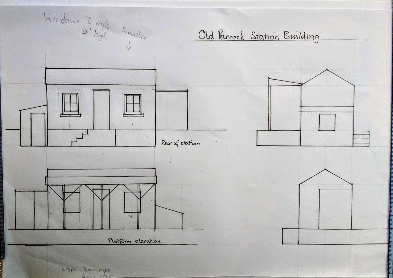

This photo shows the platform base with the extra piece at the rear for the building which I've designed by drastically reducing the vernacular KESR architecture. This is my indicative drawing:

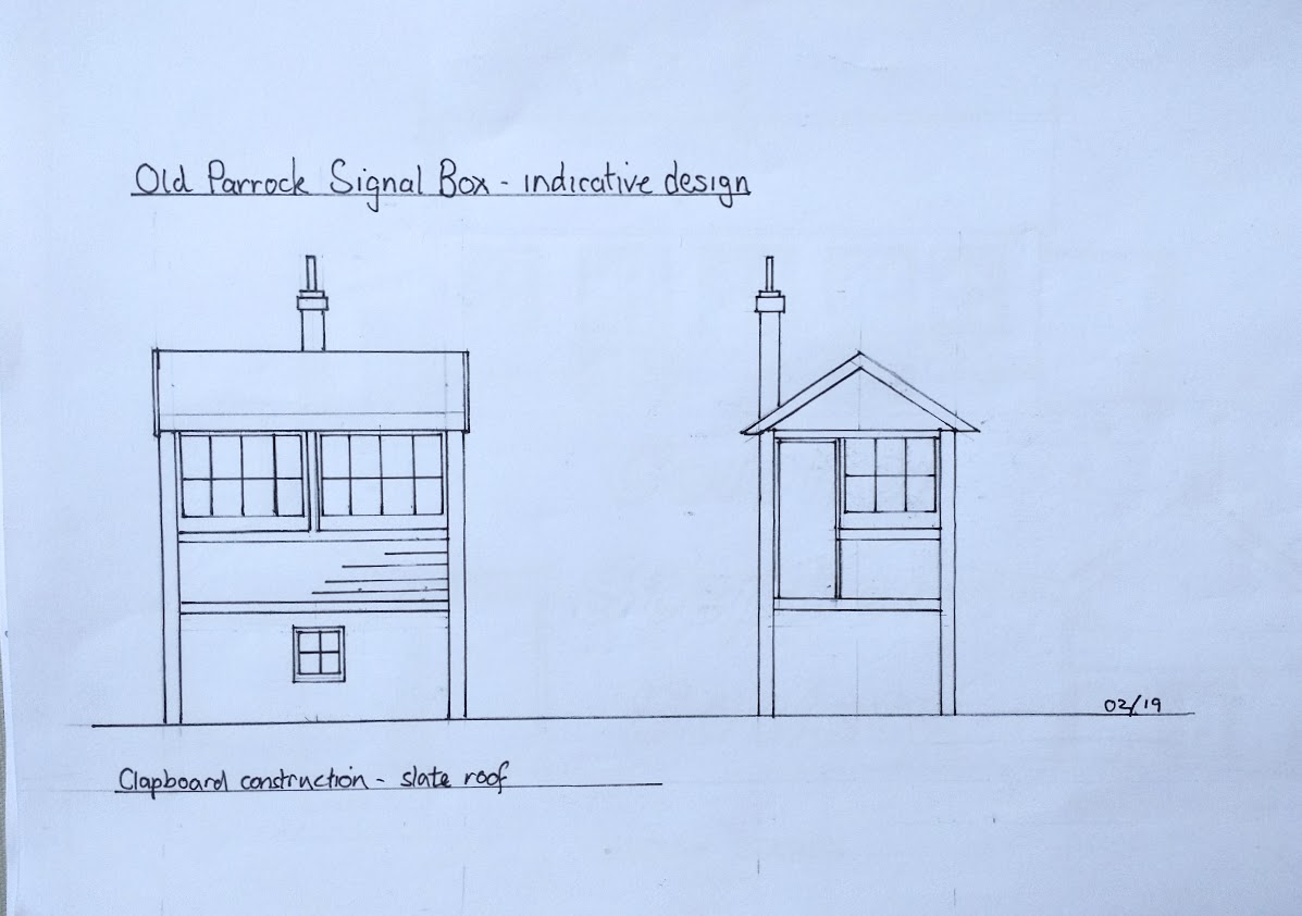

The intention is also to have a small signal box which is an loose amalgamation of two small LBSCR signal boxes - Northwood and Fittleworth:

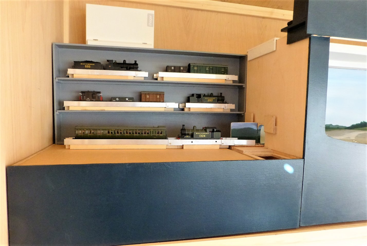

Because it's now a terminus I realised that I need to be able to swap locos back to the front in the fiddle yard, so that has been completely re-designed - this has been my focus for the past few weeks - those cassettes take an age to make:

Thanks for the photo Dave, that has real atmosphere. I like the Victorian delicacy of it. I'd need to reduce its size.
However, you have set off a train of thought and a research trail. There's an early photo of Brighton Yard signal box (I can't reproduce it here as it's copyrighted, but you can do a search) which is also wooden and on stilts - and basic. It may adapt very nicely to my layout.
Another alternative is to have a covered ground frame which may be more likely, but I want a slightly more imposing building to offset the small shed and station. Art versus likely historical accuracy?
76043
I think if the line is on the 'one engine in steam' principle, tablet or staff would be issued, see link below.
OES staffs
Therefore as Paul says a ground frame would be all that is needed to control the station area turnouts. In terms of signals I suppose a starter might be added, but I'm not sure it would be needed. Reading the Cavan & Leitrim book recently, that line used staffs/tablets and had staff employed in the ground frame at some locations to manage the trains, but other parts of the line the train crew managed the ground frames.
Tony
76043
No problem, I'll have another look in the C&L book, because I think signals were put up where the ground frame had a signalman, but not where train staff worked the frame.
Tony
Makes sense that for there to be a signal, there would need to be a signalman of some sort, and more than one engine in steam.
You wouldn’t want to pull the signal off, drive past it, stop, walk back and return it to danger to protect yourself from a train in rear that couldn’t be there...

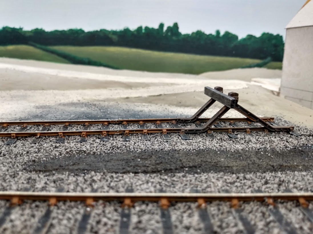

I've made up a Brighton Buffer stop and a couple of PO wagon kits and now the layout is wrapped in newspaper because I'm about to paint the track. I've been experimenting with various ideas for this and just want to check my consistency this morning before committing paint to precious trackwork - another one of those irreversible anxious moments is coming up!

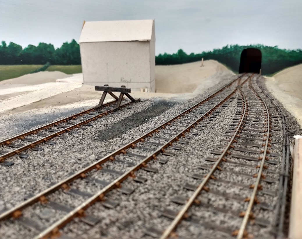

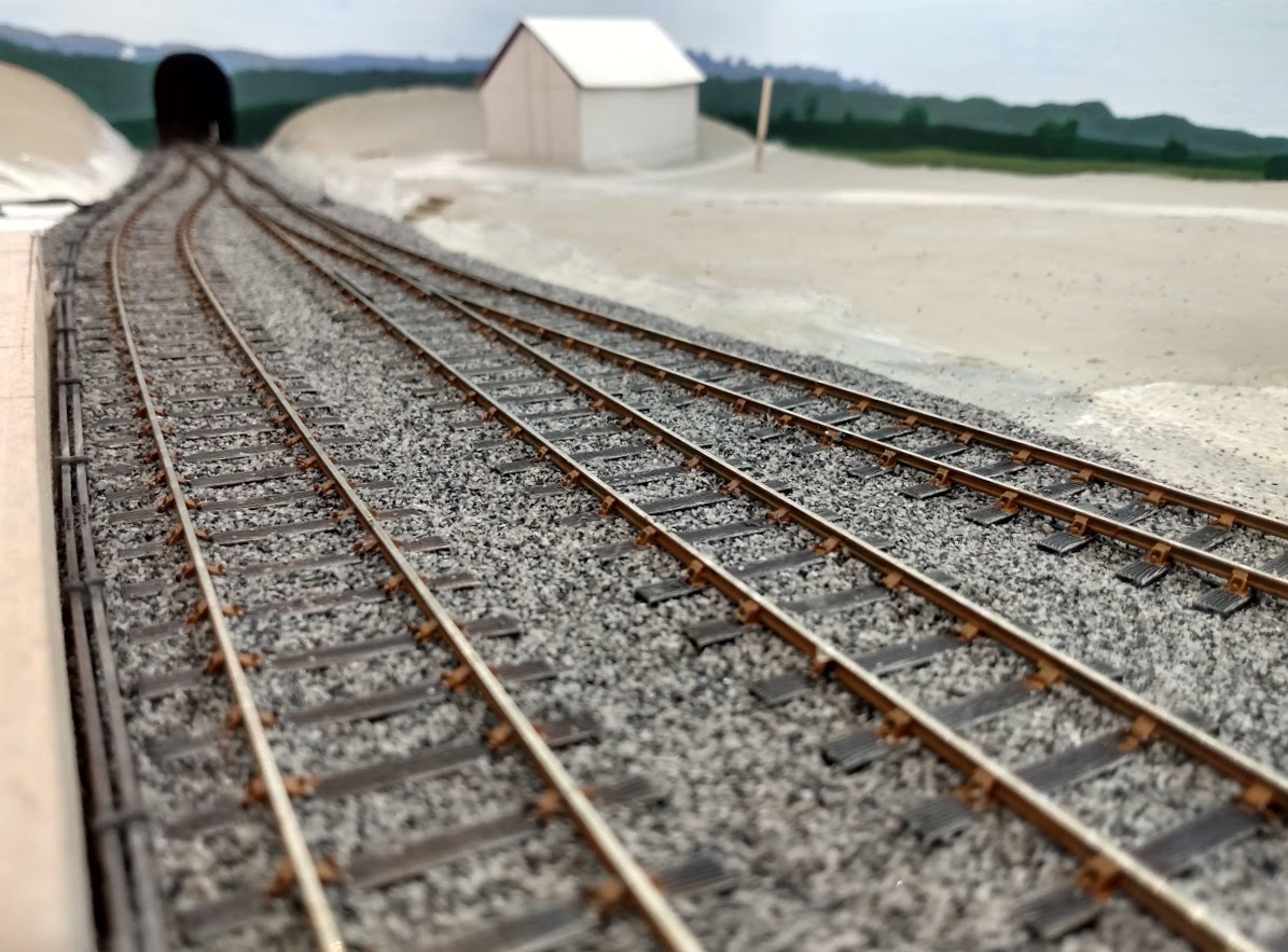

I realise that these photos may look a little boring, seeing as they are basically scenes of empty track, but to me they are very exciting and represent a month of diligent application of new skills. My track is now painted, has point rodding, a set of buffer stops and ballast (the ballast and track is set for some judicious further weathering this week). Added to this, there are magnets buried in there at key and hopefully useful places to enable the miraculous working of Dingham couplings.
Being a bit of a technical dinosaur, I can also state with relief that the electrics and points are also all working.

76043
The ballasting and track looks really nice, the sort of look I'd like to achieve, would you mind explaining your techniques a little?
Tony
PaulR
Tony
Thank you for the kind comment Tony.
I looked at lots of photos of track, particularly in my geographical area of interest. As we all know, photos are notoriously difficult to assess in terms of colour so in the end I got as near as I could - but went with my instinct about what looked right to me.
First of all, and this was the scary bit, I sprayed the whole thing with a can of Halfords Car Matt black spray. I then dry brushed the sleepers with a progression of Tamiya Acrylics - Light Grey XF66, Flat earth XF57 and White. I did this a little at a time, stopping to ensure that I wasn't overdoing it. In fact I may have actually underdone it.
The rails and chairs were painted with Humbrol Matt 62.
The point rodding is Wills Point Rodding SS89, and I'm indebted to the modeller of 'Little Muddle' (whose name I believe is Kevin) for this excellent article on how to set it up: Installing point rodding and a signal box - Part 1
I painted mine slightly differently, once again photos offered huge colour variations so I made my own decision about what looked right. Mine were painted with enamel colours, Humbrol Matt 113, brushed in with an old colour pot I found in my box, Revel Matt 79. Humbrol 113 is possibly a bit too 'purple'.
The ballast is mainly Gaugemaster N Gauge Granite Ballast GM115, with some Woodland Scenics Fine Buff B73 mixed in. I can't actually tell you the proportions because I mixed it quite a time ago. It was glued down in the usual way, soaking it with water from a spray diffuser, then pipetting a mixture of 50/50 PVA and water with a little Fairy Liquid added.
Once dry, finishing touches are being added using weathering powders. I've done this on the point rodding so far, but I want to darken down the rust a bit and the ballast between the tracks a little, especially in the station area and the yard. For this I'm using two AK Pigments, Smoke (AK2038) and Europe Earth (AK 042).
I must admit to being pleased with it. In the end I had to just take the risk and go for it - and this time it seems to have worked.

Thanks Paul, that's really helpful, I shall be giving it a go using your technique quite soon.

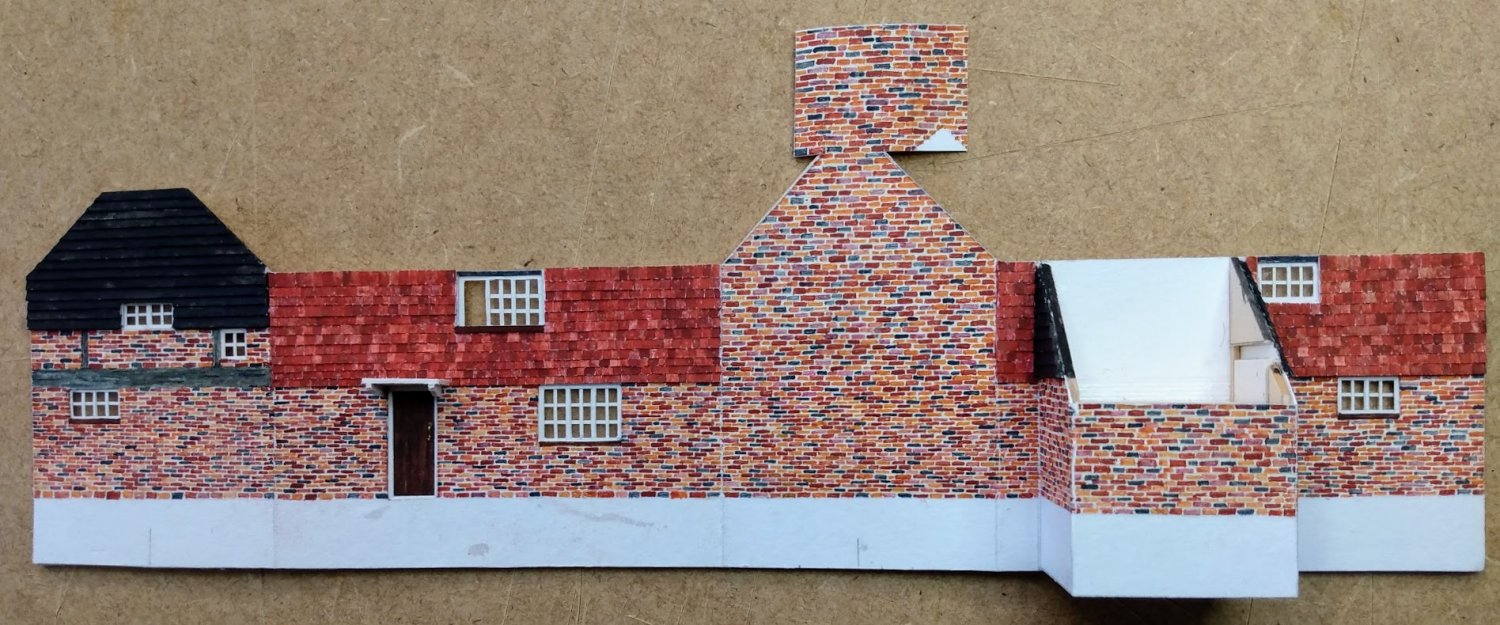

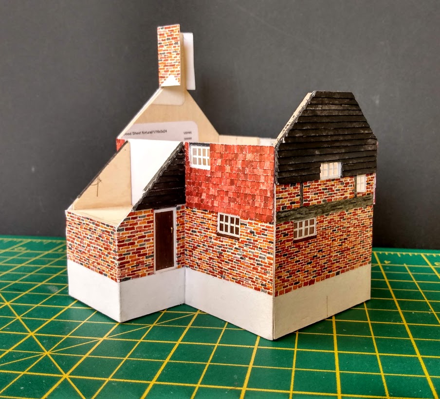

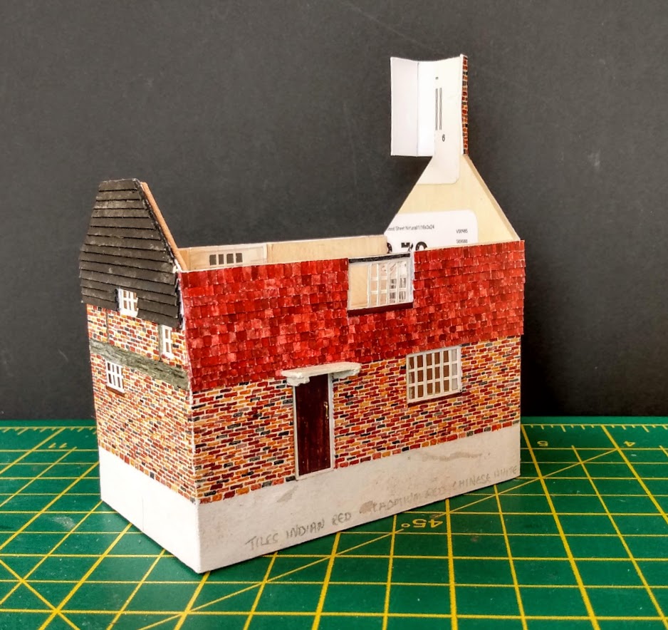

Here's a quick update on progress with the cottage:
The next stage is to fold it up and glue it. I'm using 1/16" basswood for the frame. There will be touching up to do once it's constructed, and the roof, doorstep, down pipes etc, all those things that bring it to life. I'm cogitating on how to tone the colours down a bit as it looks a little bit like the Technocolor of a 1950s western at the moment - more on that later.
