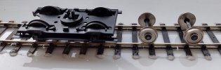

I've also been tinkering with converting a Hornby Ruston 48DS to EM. I looked around in the various spares boxes and came across some Gibson 2mm axles, probably P4 and some 10.5mm Tenshodo spud wheels. They are 'alf a mil to big, but I'm only a 'alf hearted rivet counter. The EM society suggests using lowmac wheels, also 10.5mm diameter, so if it's good enough for them... My conversion also has the advantage over the Gibson option in the the pickups don't need to be extended to the rims, as per Gibson wheels.
So here's the wheelsets, with a Hornby Gresley bogie, also freshly converted to EM.
Then the final conversion, which I did in an evening!
And the loco sitting on blocks running in, using the match wagon for power.
