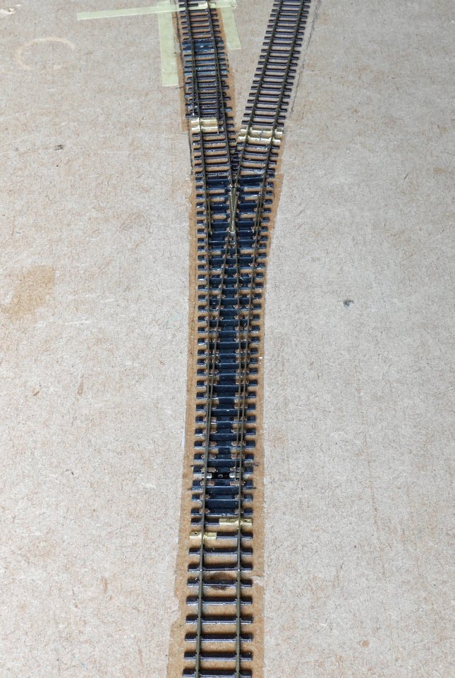

    The common crossing is milled from a single piece of nickel silver and greatly assists the novice builder. The chairs appearing to support the crossing are just plain Easitrac chairs i.e. not the pegged variety, which are simply cut in half and glued on to improve the look.
    That's it for now. I've got a busy modelling weekend coming up so will be back next week to 'play nicely' again. Might get a chance to have a good look around WT as well to see what everyone else is up to.
    Mick
    Cameo Callaton
  • Simpas
    A little update, below is a picture of the single turnout which started life as a right hand B7. It's possible to make out the beginning of my first working trap point, of which more anon. The bright coloured sleepers are brass castings used to supply feed to the rails. Just below the switch a large hole is where an electro magnet will be positioned for uncoupling using my now standard Electra Couplings designed by John Whitehead around 1979.

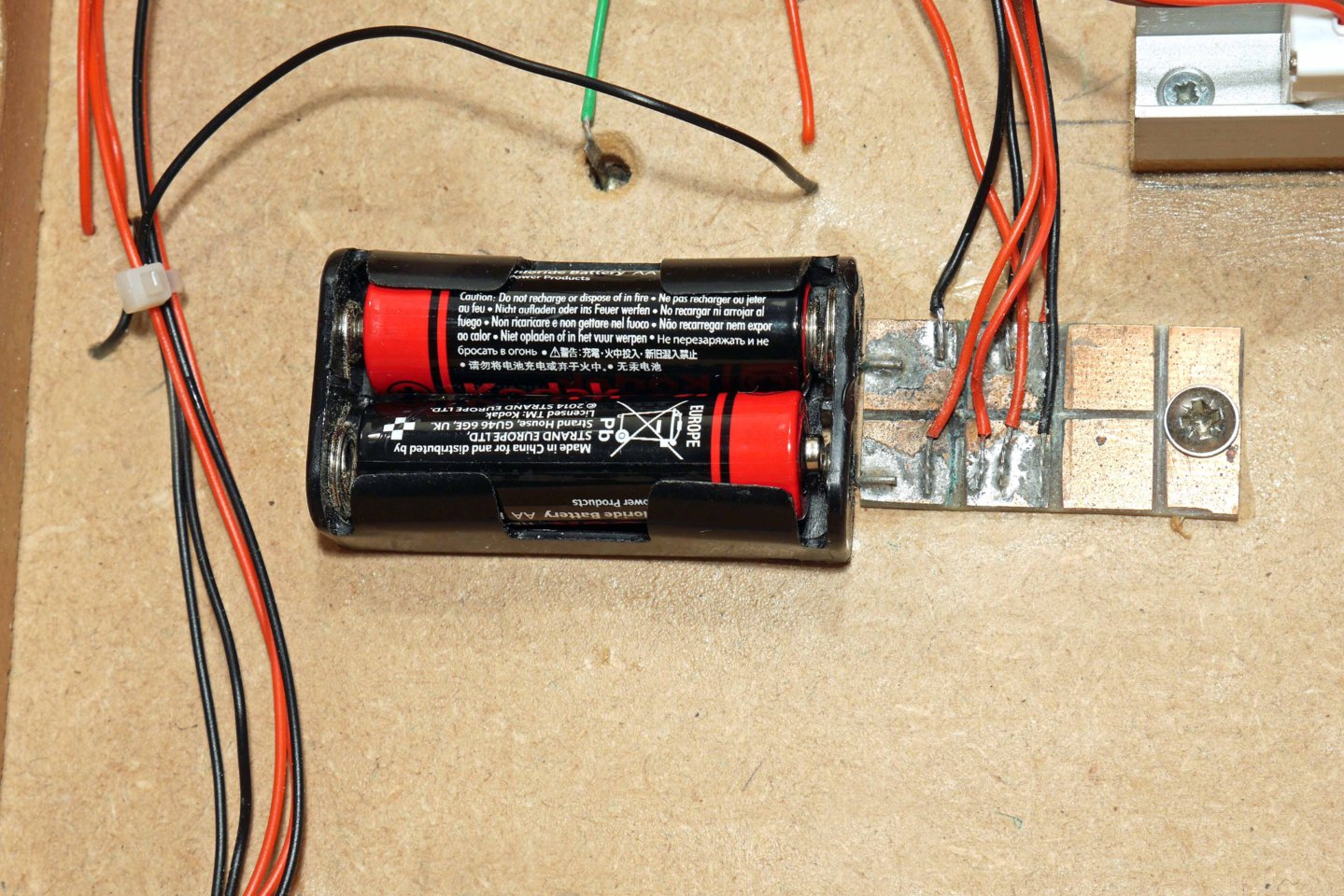

    I'm back again and would like to show how things are progressing. With the attempt to illustrate so much in so small a baseboard things inevitably will get to a stage where they look over busy so we'll start simple...! Below is the baseboard underside with the 'bus' in place. I'm making an assumption here (always dangerous) that everyone knows what a bus is. If not shout up...! To the right side can be seen a servo mounting and an electro magnet. In the middle - a piece of aluminium 'U' channel that will hold the servo that actuates the trap point. At each end of the board you can see I have clamped pieces of mdf, using 'T' nuts, that allow me to invert the board without running the risk of damage to the topside.
    Just a few words here about the servos; these are standard items bought via the Internet for less than £2.00 each but with the electronic components removed, leaving something that might best be described as a motor and gearbox inside a servo casing. This is not my idea and I am grateful to fellow 2mm Scale Association members Bob Isgar whose idea I believe it was to rip out the electronics from the servo, and David Long who pointed me in this direction. It is however reasonable to add in here that since there is nothing new under the sun this might not be a new development so apologies to anyone who thought of this earlier and is not being credited here.
    What needs to be done is the electronics, in the form of a small circuit board, need to be removed completely and two new wires soldered to the poles of the motor. You're exactly right "thez nee pictchas of the sorvos gutts" (there are no photographs of the servos inards)
    The wires are run off from the servo unit and connected to a supply which can be something as simple as a 1.5volt battery via a double pole double throw switch. The centre terminals of the DPDT are connected directly to the motor and the outer terminals connected to the power supply. One pair have the polarity reversed which simply means holding the switch over in one direction powers the motor forward and in the other reverses it - really simple. The power in this instance is a plastic case containing two AA batteries as seen in the picture below. Little cases like these can be bought for under £2.00 from the electronics dealers who ply the model railway shows. They’re also obtainable on the High Street where you might pay a little more for them, but still not very much. I have some which will hold one, two, four or eight batteries which will provide me with 1.5v, 3v, 6 v or 12v. Because a bias centre off switch is used it is simply held over one direction until the motor stalls at which point it is released.
    Whilst making the servo operate in the way it does is definitely not my idea I may have individualised the way it operates the piano wire shaft that moves the switch tiebar, because it is this aspect I have not seen before. The two pictures below show what's happening I hope, in the time honoured 'spot the difference' style. This servo is in fact the one operating the trap point and has the micro switch for the one and only point on the layout (did I say layout..?) ganged in. I have some pictures of the 'cobble up' that is the micro switch mounting but it's reasonably obvious what is happening from these two shots.............oh, alright then, I'll explain.
    I am using the full amount of travel the servo has to offer; there’s no electronic servo controller at all, it’s all really simple with about 75% - 80% of 360 degrees being travelled by the servo arm. Switching power on simply sets the motor running and when it reaches its own limit within the casing it stalls, the DPDT switch is released and the switch blades are held over because the low gearing within the servo act like a spring - job done. Also to be seen in these views are what I think is my own take on the switch actuating rod, a length of 0.6mm piano wire. People normally make a Z bend of sorts with the operating wire which is fed through one of the holes in the servo plastic actuating arm and use servo controllers to restrict the amount travel. If the Z bend method were employed here the actuating piano wire would protrude above the tie-bar into the scenic area every time the switch was thrown then fall back to the 'at rest' position when the servo stalled. A separate piece of scrap brass is used as a fulcrum (seen in the picture) through which the piano wire passes. At this point there is a piece of mercontrol tubing soldered above and below the pivot point preventing up or down movement when the servo arm rotates. (otherwise the piano wire will fall out…!) It is feasible to drill a hole in the aluminium ‘U’ channel to use as the fulcrum but I decided against this because it’s easier to thread piano wire up through the hole in the turnout tie bar and fix in place if the servo and ‘U’ channel are separate entities at the time.

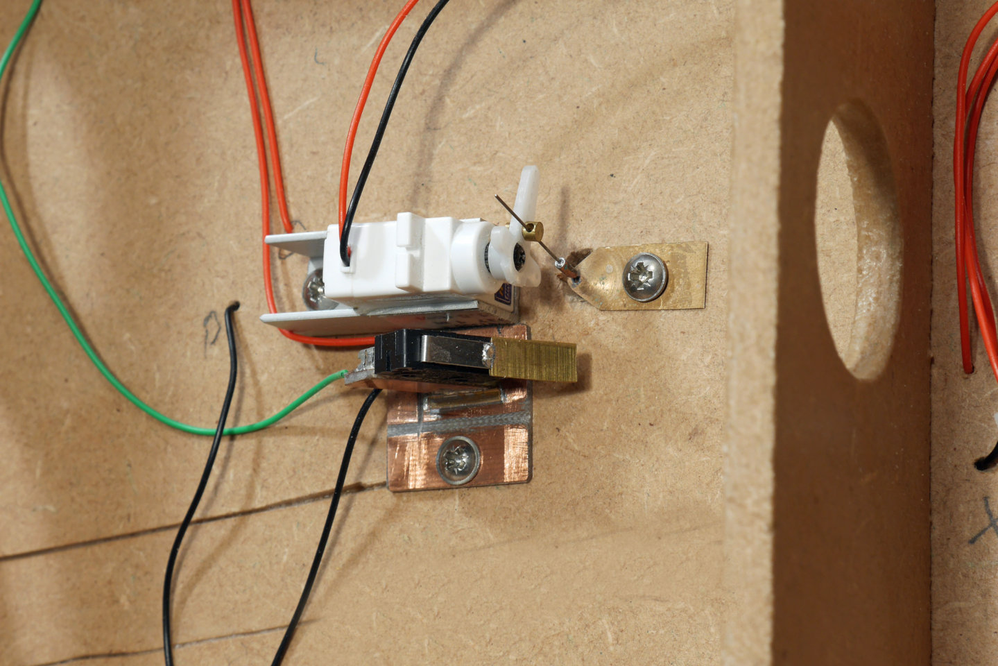

    Anyway - off we go. Here are some closer up shots of the servo (which is not really a servo now..!) and shows the component parts of the turnout and trap point operating mechanisms.
    Below can be seen the construction of the mounting for the micro switch from scrap PCB and brass angle - a proper 'botch up', but it works which is what matters, and needs little explanation. Refer back to previous pictures illustrating the movement and it will be apparent the micro switch can be changed out in seconds. without the need to employ a soldering iron. The change can be done is in seconds.
    A little piece of 10 thou brass has been used to extend the arm that operates the switch and this can be seen in both pictures. It's simply folded over with friction ensuring it doesnt come off. If it needs anything else to retain it a dab of solder or a spot of superglue will do.

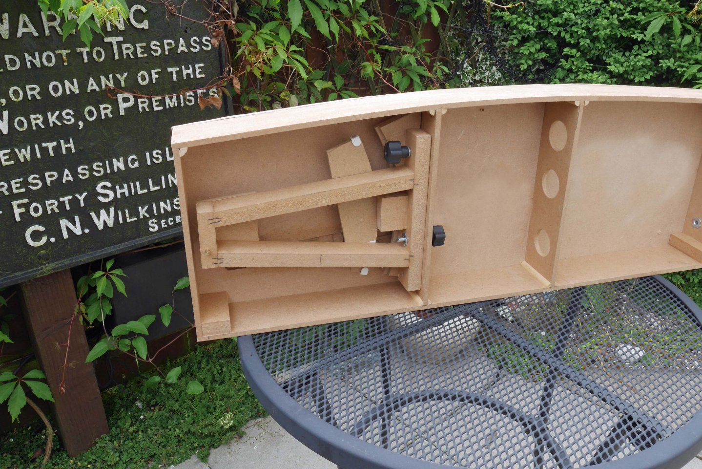

    Jonte asked a little while ago about the sector plate so here is an underside view of the way it has progressed. It has been wired up and as can be seen is still a very simple affair. The unplugged plug dangling, is the feed from the main board and the two wires are soldered to a piece of PCB. It feeds the short section of track on the non moving section of the sector plate (left) and the track on the moving portion of the plate (right) via the switch. I used an inline plug and socket to enable me to remove the sector plate itself without having to get the soldering iron out. I need to take a couple more pictures of the sector plate from above to illustrate the simple alignment 'peg' so may try and do that today...!
    Can you spot the curious Otter...?
    The fiddle.
    There is one proper hidden fiddle siding that runs the length of the main baseboard (all 2' 6" of it..!) and what follows is my method of connecting it to the sector plate board
    You have already seen the main single road sector plate at the right hand side of the layout which has limited capacity (one train length) but comparing this little project with the prototype that inspired it, there will be twice the number of trains appearing in model form than was the case at the real location so these fiddle arrangements I am about to describe should be more than adequate. I needed to be able to have some means of storing the train that was not being 'run' at and achieving this is the single road storage/fiddle siding behind where the back-scene will be. In order to avoid too much fiddling about with alignment when the sector plate is being attached I decided not to have a second track joint at the baseboard edge and instead opted to simply lay plastic track base on the sector plate side and slide the rails through from the layout proper. The single fiddle track road will not be painted so sliding the rails back and forth is relatively easy and it's a sure fire way of letting me know the fiddle yard is correctly aligned. See images below - upper view shows the rails before they are slid across and the lower shows them in place ready for traffic. Before you ask, the track on the sector plate is concrete sleeper flat bottom stuff, believe it or not this has raised detail which reads 'DOWMAC', the marvels of spark erosion technology...! Available from the 2mmSA as are all the plastic track products.

    Below, on the main part of the baseboard, the sliding rails to the sector plate, bottom of picture (the upper track is the 'main line'). These are electrified by two pieces of PCB being fed from the bus below decks, using a soldered connection seen to the right of the plates in this view, with a phosphor bronze wiper soldered to the underside of the rail and bearing on the plate maintaining contact as the rails slide through.
    In the photograph below will be seen a similar system is employed at the other end of the layout where the 'main line' and explosives siding disappear off scene. I moved away from the single fiddle stick idea adopting a broader approach, in more ways than one, and used this opportunity to extend the explosives siding on to the same fiddle base. This effectively gives me two fiddle roads at the left hand end which will mean additional flexibility allowing me to 'hide' a cut of wagons from public view. There is another beneficial effect of this; because I have no photographs or detail of the explosives facility that existed at the real Callerton, I can now just imagine it is some way off beyond the bridge which will form the scenic break into the fiddle at the left hand end and not be subjected to comments like "it was never like that". Electrical feed at the moment is only to one of these two fiddle roads, the one at the bottom of the picture, and is achieved slightly differently to the long fiddle siding by connecting wires soldered to the base of the flat bottom rail and allowing the rails to slide into the first three chairs on the layout in much the same manner as the long siding does on to the sector plate. This can be seen below with electrical feed to the front one (in this view) of the two spurs. The other road is not fed at this stage but could quite easily be if felt necessary in future. The Peco buffer stops are there to allow the three sleepers worth of rail to disappear and not run the risk of my careless clothed arm catching them. The visible wire and plug connect to the bus.

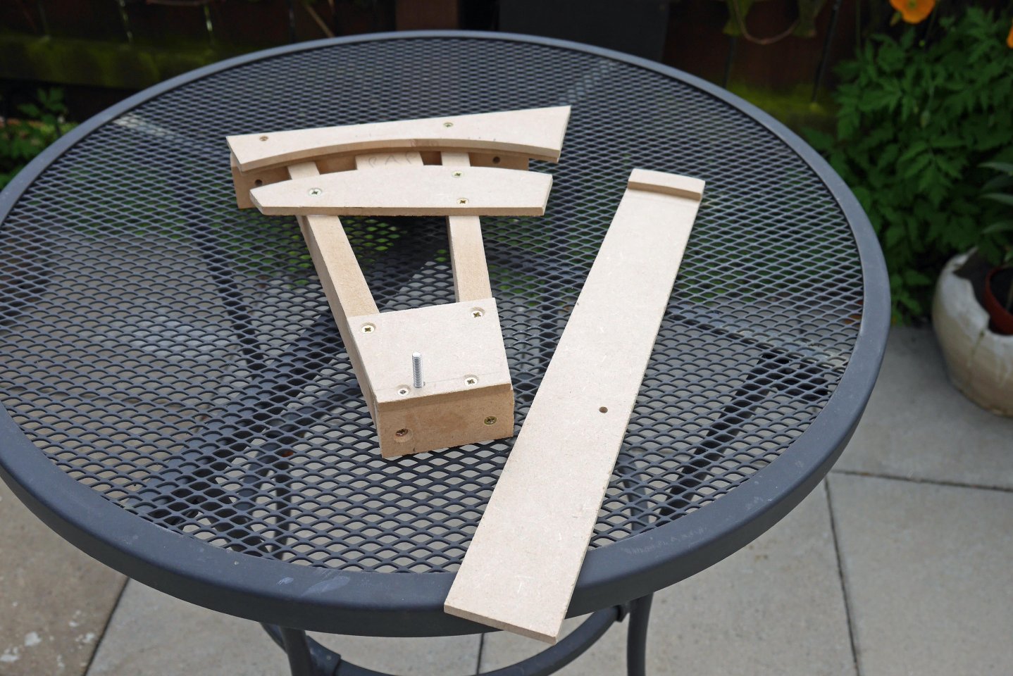

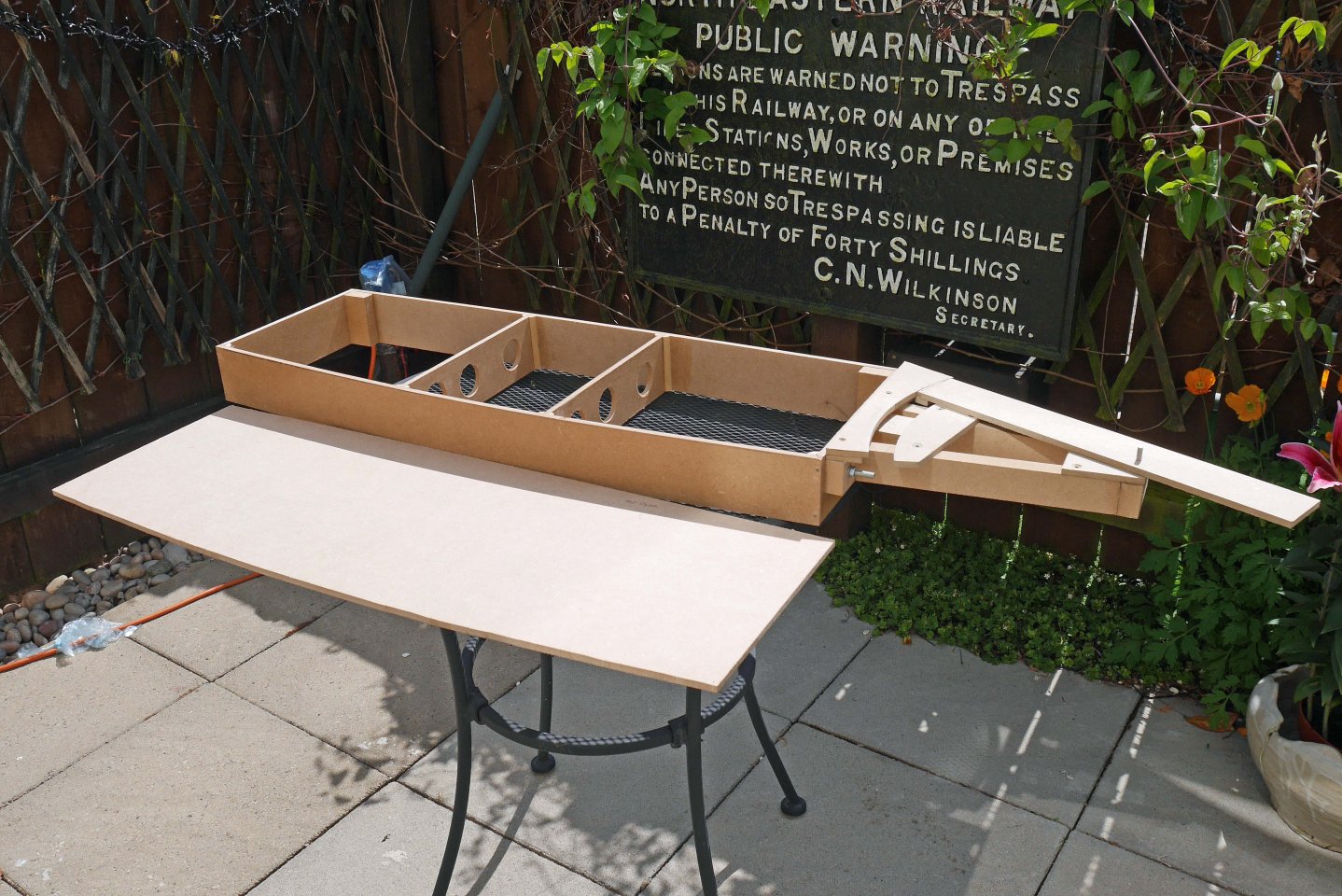

    Here are shots shots taken today showing the sector plate viewed away from the main baseboard.
    It can be seen I have added a couple of sides to the plate to prevent accidental plunges to the floor. Looks as though it could be ineffective but, surprisingly, things don't seem to go very far if accidentally knocked. (I don't think it would withstand a size 9 boot mind but thankfully there aren't too many layout kickers about these days..) It's aligned to the rear hidden fiddle road in this view the alignment being achieved by two carefully drilled holes lined with copper tube in the bearing plate. A short piece of brass rod which is a comfy fit inside the tube drops into a similarly lined hole in the base bearing plate. I soldered a short piece of the copper tube into a bit of double sided PCB and this extends into the sector plate with the fiddle track on. Because of this it only needs a single screw to secure it. I'm just showing off with the little knurled brass wheel but does have a function - the extra mass generated means the 'peg' can drop into the hole in the bearing plate under its own weight as soon as it reaches the drilled locating hole. The locating hole for the other position can be seen just above and to the right of the visible screw that keeps the bearing plate fixed to the base and in this picture it is possible to discern the mark left by the brass peg as it tracks over the bearing plate. I did consider springing the 'peg' but quickly went off the idea because it makes a satisfying 'tink' as it drops relatively freely into the tube.
    Aye, I've splashed a bit of matt black paint on the sides as well....!

    Below, a view of the sector plate aligned to neither of the roads but shows the brass 'peg' from which it is hoped can be gleaned the simple nature of the alignment.
    And here it is in the position it would be to enable the train to leave the fiddle and enter the scenic part of the layout. Astute observers will see I have dispensed with the MDF washers where the 'T' nut bolts that secure the fiddle yard to the layout are located. They turned out to be a bit flimsy so I stuck a couple of larger bits of wood in - much better.
    That's about it as far as the sector plate goes. It's the first time I've built or used one and I'm pleased with the way it works.
