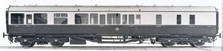

The final GWR coach on the construction list to replace a damaged Hornby Hawksworth. This D127 brass model uses Comet sides and my parts and will benefit from the scrap Hornby interior and bogies. The D127's were built between 1938 and 1941...
The bottom door hinger were soldered into slots last night. Middle and top hinges will be from 10thou plastikard...
My floors have fold-up ends. The excess solder is to hold the folded up steps rigid...
The brake end did not have steps, so I used a Comet plain end off a non-corridor coach...
